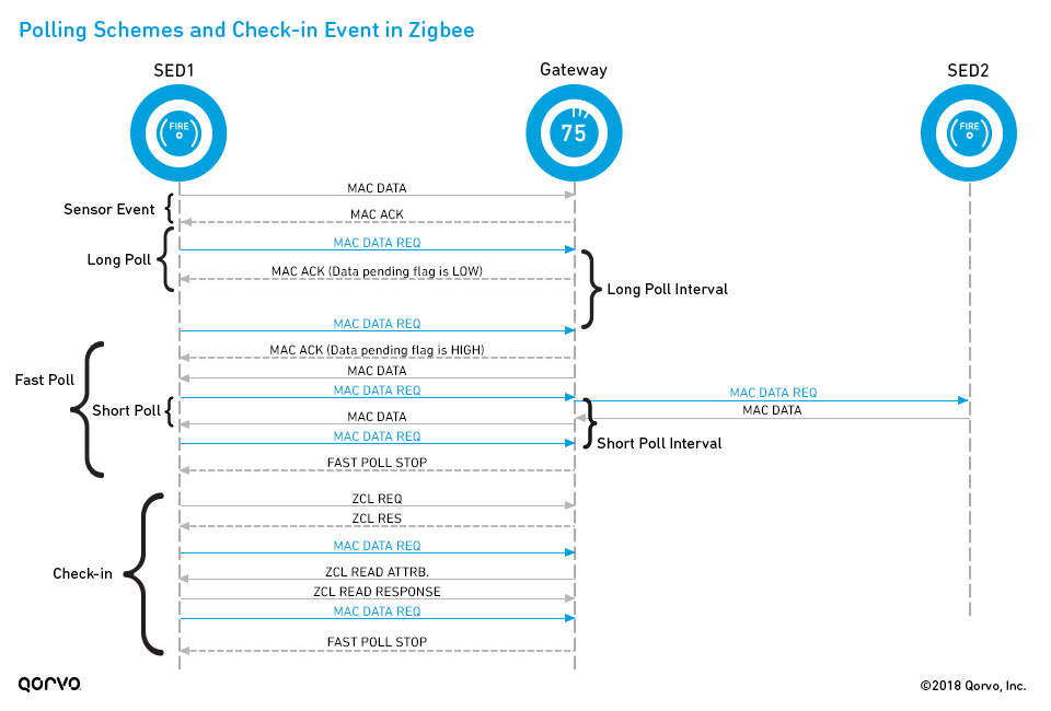

Short polling
The SED may start short polling, where it performs a high duty cycle MAC data request to retrieve messages requested by it from other end devices. In the figure below, SED1 sends a data request to SED2 via the gateway. SED1 then continuously polls the gateway to receive the response from SED2. The SED1 is now said to be in “fast poll mode,” which lasts until the expiration of the “fast poll timeout” or when the SED receives the “fast poll stop” command from the gateway.
Long polling
Long polling allows an SED to periodically report to its gateway. These are low duty cycle MAC data requests. They also provide an opportunity for an SED to retrieve a message from the gateway. The gateway:
  • Stores this message for a period of 7.68 seconds
  • Indicates it has a message for an SED by setting the data pending flag in the ACK high, as shown in the figure below
  • Then sends the message to the SED as a MAC data packet
Check-in events
A check-in event is a very low duty cycle event generated by Zigbee’s application layer via a Zigbee Cluster Library (ZCL) transaction. During check-in, an SED can receive data from the gateway, which can normally reside longer than the defined 7.68 seconds. The gateway can then initiate fast poll mode, where it can send data until the fast poll expires (or until the gateway sends a “fast poll stop” command). The gateway can also update the poll control parameters during the check-in event. Check-in events are ideal for performing firmware updates or collecting diagnostic data from sensors. As shown in the figure below, the gateway sends a ZCL read attribute command during the fast polling phase of the check-in. The SED responds with the “ZCL read response.”
Understanding Zigbee: Polling Schemes and Check-in Events

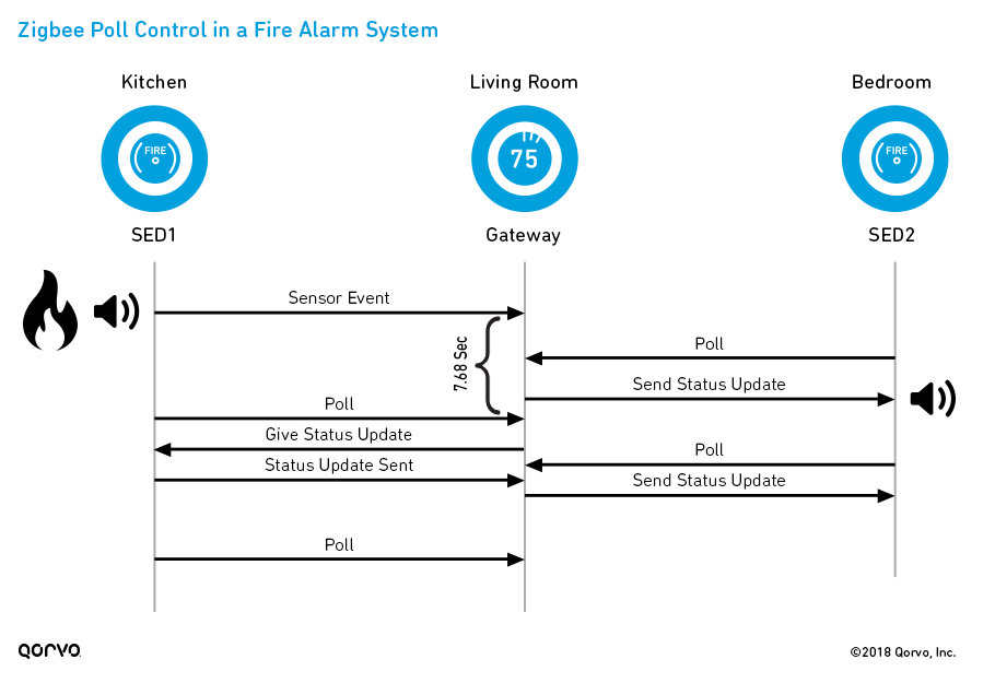

Let’s use an example of two Zigbee-based fire alarm sensors placed in the kitchen and the bedroom, which we’ll call SED1 and SED2. Both the sensors are communicating to a Zigbee gateway (in this case, a smart thermostat). SED1 detects a rapid rise in heat and smoke in the kitchen. It sounds the alarm and updates the gateway about the situation developing in the kitchen. Meanwhile, SED2 in the bedroom still doesn’t detect the heat or smoke from the kitchen. How quickly can the gateway update the fire alarm in the bedroom to sound the alarm?
Understanding Zigbee: Zigbee Poll Control in a Fire Alarm System
When SED1 detects fire, it will instantaneously wake up and send an alarm event to the gateway. This message will be stored for 7.68 seconds on the gateway. The gateway can then send an update to SED2 upon receiving a long poll data request from it. Using the default settings above for our sample Develco fire alarm, SED2 can sound the alarm in the bedroom in less than 7.5 seconds. The gateway can ask for a status update from SED1 at every long poll event and relay it to SED2.
