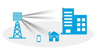

MU-MIMO involves equipping internet routers with more antennas to extend network capacity in the home, without requiring more spectrum. This approach is similar to massive MIMO, where network operators add ten-times the normal number of antennas to a cell tower.
Both are typically combined with beamforming technology, which drives signals directly to the point of use. Beamforming focuses the Wi-Fi signal from the antenna directly to the device to improve signal strength and range.
