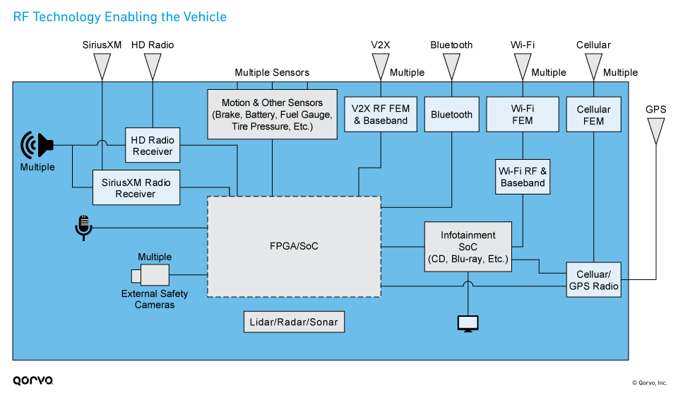

Today’s vehicles have a lot of electronics connecting it to the world. For RF systems, this means the RFFE chains abound as vehicle manufacturers place more telecommunications in the car. The following diagram shows an example of a generic system.
RF Technology Enabling the Vehicle

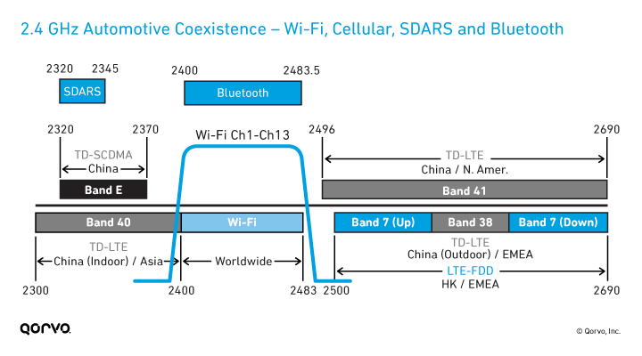

Addressing RF coexistence
Users who are streaming video expect fast, reliable service in their automobiles, and streaming from the network and inside the vehicle are quickly becoming the standard. As a result, it’s important to minimize coexistence issues and reduce line loss when maintaining streaming services.
But maximizing coexistence between wireless bands and standards is challenging. If proper filtering isn’t used, there’s an increased potential for coexistence issues at the following frequencies:
2.4 GHz:
  • Wi-Fi and cellular communications, like LTE Band 41
  • Wi-Fi and Bluetooth
  • SDARS (Satellite Digital Audio Radio Service) and LTE
5 GHz:
  • Wi-Fi and V2X (802.11p and C-V2X)
  • V2X and U-NII (unlicensed national information infrastructure) bands, specifically U-NII-3
Related Blog Post: V2X in the Connected Car of the Future
Diagrams of the 2.4 GHz and 5 GHz spectrum show how crowded the bandwidths are for wireless technologies used in connected cars.
2.4 GHz Automotive Coexistence – Wi-Fi, Cellular, SDARS and Bluetooth
5 GHz Automotive Coexistence – V2X and Wi-Fi
So, what’s the best way to mitigate these coexistence issues? Some best practices are to use high-performance RF filters and highly linear active devices in your design.

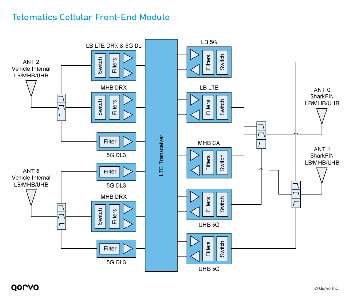

Automotive Front-End Module Design
Vehicle engineers were once only concerned with GPS and Bluetooth, but now they must design for new wireless standards like C-V2X and, in the future, 5G New Radio (NR). Designers must learn all the technology shown in the block diagram below, while incorporating it into their automobile designs. The most likely approach will use mobile phone technology as a springboard.
Automotive Telematics Cellular Front-End Module
Qorvo engineers created RF Fusion™ to help our customers leverage an integrated solution, which effectively reduces design complexity and enables faster time to market. Many of these complex modules include embedded filters, which further reduce the RF complexity and the overall link budget.

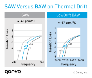

  • Use RF filters with minimal or no shifts over temperature. As shown in the next image, filters drift to the left or right due to temperature changes. For automotive systems, it’s important to use temperature-compensated filters with outstanding temperature stability, low insertion loss and a high Q factor, such as Qorvo’s BAW technology, to help counteract issues related to heat (as well as coexistence). On average, BAW technology is 50% more temperature stable than SAW.
  • Use highly linear front-end products. PA efficiency is attained by using highly linear front-end products, which optimizes system efficiencies and creates less heat. It’s important to keep insertion loss minimized in the RFFE — especially when running hot. Poor RFFE performance affects current draw on the entire automotive system and makes the system’s processor work harder. In turn, this causes thermal heat, system degradation and draw on the vehicle battery.
SAW Versus BAW on Thermal Drift
