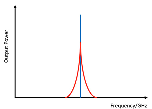

Phase noise is commonly used as a measure of frequency stability within an oscillator. This noise is inherently different than the general background noise of any electrical system, which is defined as kTB, where k is Boltzmann’s constant, B is the bandwidth, and T is the temperature. Instead, phase noise is a secondary effect directly related to the topology and construction of the oscillator.
Graph of ideal signal vs a signal with phase noise
Figure 1: Ideal signal (blue) and a signal with phase noise (red).

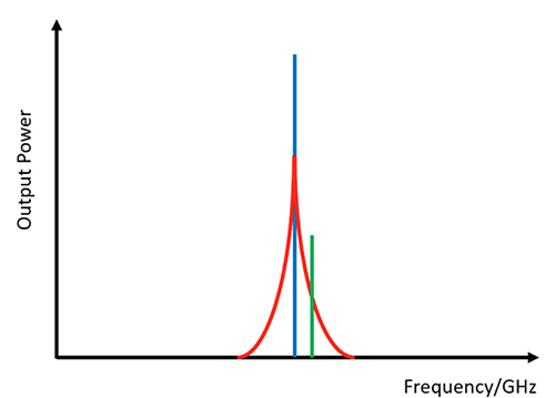

In Figure 2, we can see that if the power level of the RF signal we wish to convert falls below the phase noise spectrum of the LO signal, we will be unable to recover any baseband information, as the signal will be in the noise. Therefore, reducing the phase noise will increase our receiver sensitivity.
Graph of an ideal LO signal vs with phase noise and RF signal to convert
Figure 2: Ideal LO signal (blue), an LO signal with phase noise (red), and an RF signal close in frequency (green) we wish to convert to baseband.

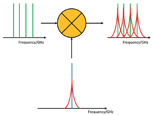

In Figure 3, we present how phase noise can negatively impact a conversion, this time of a multi-carrier orthogonal frequency-division multiplexed (OFDM) signal. In this figure, we note that if the phase noise of the LO is too high, then the noise will be converted into adjacent channels of the baseband data, thereby ruining the integrity of the information.
Phase noise issues in OFDM systems.
Figure 3: Phase noise issues in OFDM systems. Ideal LO signal (blue), LO signal with phase noise (red), RF signal (green).
