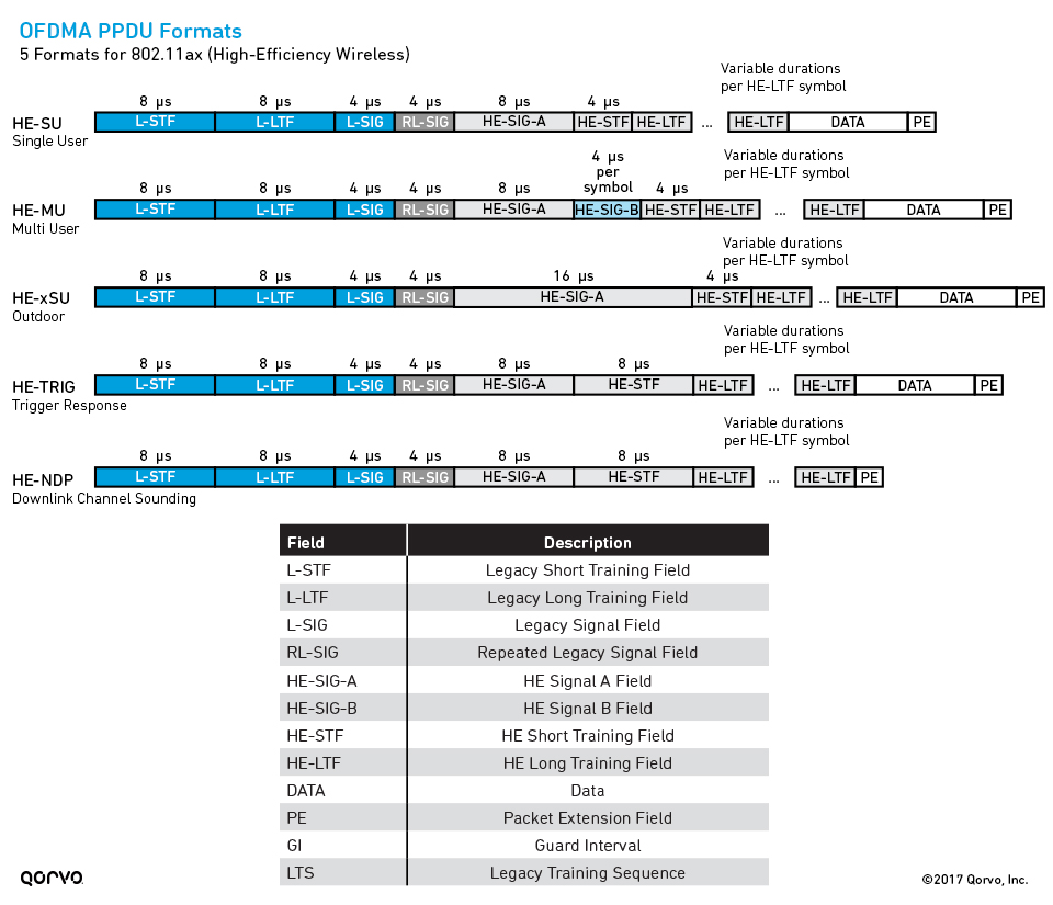

Some background: 5 OFDMA PPDU formats for Wi‑Fi 6
But first, let’s look at the foundational signal structure for Wi‑Fi 6 (802.11ax) — the physical layer protocol data units that Wi-Fi clients and devices use to communicate.
802.11ax uses five formats for its OFDMA PPDU:
  • Single User (HE-SU). For transmitting data from a single user.
  • Multi User (HE-MU). For transmitting data to one or more users that isn’t in response to a trigger frame.
  • Outdoor (HE-xSU). For outdoor transmission for a single user. This format is new in 802.11ax.
  • Trigger Response (HE-TRIG). For transmitting data in response to a trigger frame. Used to coordinate uplink MU-MIMO or uplink OFDMA transmissions with the access point.
  • Downlink Channel Sounding (HE-NDP). For beamforming and downlink channel sounding.
  • See the image at the end of this blog post for details of the frame packets and fields within each PPDU format.

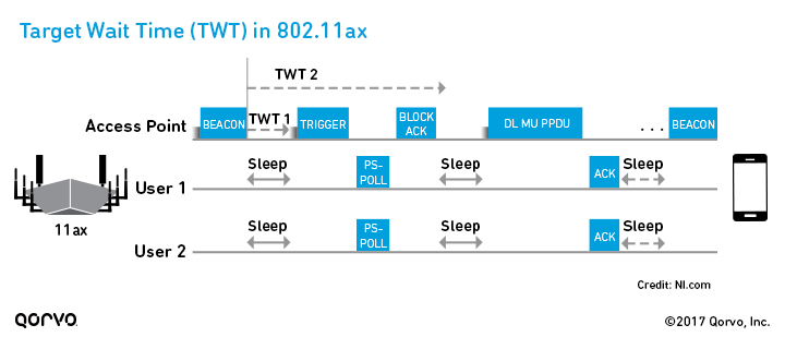

Wait or sleep times: What are the challenges for the RF front end?
One thing Wi‑Fi 6 (802.11ax) adds is target wait time (TWT) — also known as sleep times — which allows a device to stay in a sleep state longer before transmitting data. This resource scheduling improves battery life and means a better experience for a consumer.
Target Wait Time (TWT) in 802.11ax
However, latency in turn-on mode could be an underlying challenge. TWT also brings the following:
  • High susceptibility to frequency and clock offsets in OFDMA. Unlike LTE base station technologies, Wi‑Fi 6 doesn’t have a synchronized clock signal. As a result, devices will rely on the access point to keep all the devices on the network synchronized. Additionally, Wi‑Fi 6 uses longer OFDM symbols than 11ac (Wi‑Fi 5), which means more data comes through. In short, the access point will have to work harder — and be more accurate — than in the past.
  • Flatness maintained over a longer time period. The specs we’ve received from some of our chipset partners show that the initial power amplifier (PA) turn-on time has not changed in Wi‑Fi 6 (802.11ax); it’s still 200-400 nanoseconds. However, the gain flatness has been extended, guaranteeing the front-end module (FEM) has no gain expansion or gain droop for the duration of the packet.

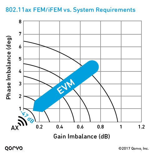

  • Tighter linearity specs for the PA. The tighter constellation density in 1024 QAM drives the PA linearity requirement to approximately ‑47 dB EVM in 802.11ax. (However, there are efforts to relax the system EVM requirement per IEEE doc 11-17-1350.) Also, don’t forget to assess the test systems required to measure these EVM levels for FEMs/iFEMs.
  • LNAs must have a lower NF. Earlier reference designs required low noise amplifiers (LNAs) to have a noise figure (NF) target range of 2.5-3 dB. In Wi‑Fi 6 (802.11ax), system sensitivity targets drive new LNA targets of 1.5-1.8 dB NF.
  • Gain expansion/droop. Ten years ago, the gain imbalance target was 1 dB. Now it has decreased to 0.3-0.5 dB. As shown in the following figure, gain and phase imbalance are being pushed to the lower left to attain -47 dB EVM.
  • The overall system margin. From a design perspective, the target PA specification is -47 dB EVM, but the actual system spec is ‑35 dB EVM. Chipset partners will typically drive for system margin.
