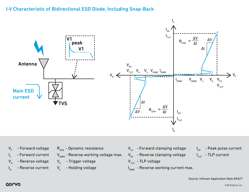

TVS diodes are one of the go-to components for ESD protection. They operate by shunting excess current when the induced voltage exceeds the avalanche breakdown voltage. They are a clamping device, suppressing all overvoltages above the breakdown voltage. They automatically reset to the off state when the overvoltage goes away but absorb much more of the transient energy internally.
A TVS diode may be either unidirectional or bidirectional. A bidirectional diode can be represented by two mutually opposing avalanche diodes in series with one another, as shown below, and connected in shunt configuration relative to the pin to be protected. These devices are manufactured as a single packaged component.
For ESD protection in RF applications, it’s mandatory to keep the TVS diode capacitance as small as possible. This avoids a detuning of the input matching, and as a result, the protection device will create less harmonic distortion.
The following figure shows the current-voltage (I-V) curve of a bidirectional TVS diode. As you can see, the TVS is symmetrical with respect to the origin, and its ESD protection capability is provided for a positive and negative ESD strike.
I-V Characteristic of a Bidirectional ESD Diode, Including Snap-Back

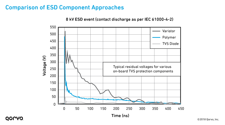

The following graph compares the residual voltages of a varistor, polymer and TVS diode in response to an ESD strike. As you can see, today’s silicon-based TVS diodes are the most effective approach to ESD strikes.
Comparison of ESD Component Approaches

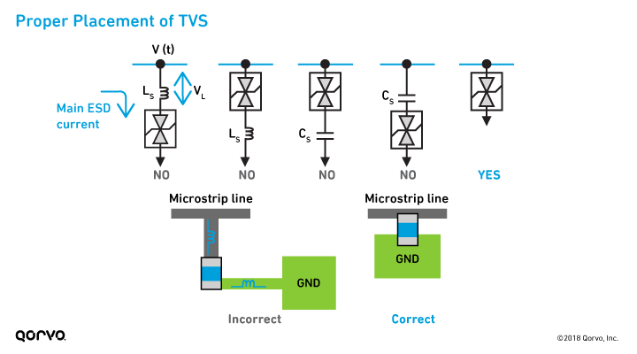

The importance of on-board TVS diode placement
However, where you place the TVS makes a big difference. ESD protection won’t be as effective if you don’t design the circuit properly. Keep in mind these general guidelines:
  • Take care when developing the PC board so traces are not lengthy, as this provides unwanted inductance.
  • Remember: Capacitors in series with the TVS device break down the primary ESD current path, while any RF inductance added to the primary ESD current path increases the total impedance in the residual path.
  • If you place a TVS properly, you don’t need all the other ESD components.
So what is the proper placement? As shown in the following image, you should:
  • Use only the TVS.
  • Don’t place the TVS before or after a capacitor or inductor.
  • Make sure there’s no trace. When you place the TVS, it should be right between the RF path and ground.
Proper Placement of TVS

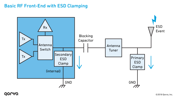

The following figure shows a high-level, basic view of the primary and secondary clamp for ESD protection in an RF front end (RFFE).
Basic RF Front End with ESD Clamping
Note: Some system designs require an additional on-board secondary clamp located before the IC to mitigate any residual ESD charge a component pin might see.

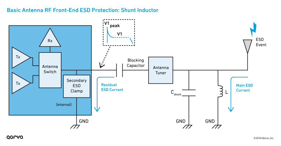

Strategy #1: Basic protection – Shunt inductor
The most basic approach uses a shunt inductor. As shown in the following figure, the inductor (L) is the main shunt element for the ESD current pulse. This inductor should be in the low nano-Henry range (<20 nH) to be an effective ESD protective solution. However, it does add insertion loss, which creates some RF performance challenges. A shunt capacitor is typically introduced for RF matching purposes, not ESD protection.
Basic Antenna RF Front-End ESD Protection: Shunt Inductor

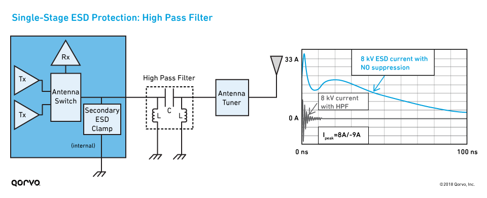

Strategy #2: Single-stage high pass filter
A second approach uses a single-stage high pass filter (HPF), as shown in the figure below. However, this may not be the most effective approach.
Pros:
  • Provides good full-bandwidth ESD coverage.
  • Can reasonably reduce the ESD pulse amplitude while allowing the cellular range to pass through.
Cons:
  • Can produce high residual voltages (Vpeak >100 V).
  • Low inductance is required to ensure optimal performance results (which means RF versus ESD performance trade-offs).
Single-Stage ESD Protection: High Pass Filter

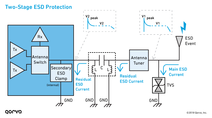

Strategy #3: Two-stage ESD protection
A third approach uses two stages of ESD protection, as shown in the next figure. This approach uses a TVS as primary protection and an HPF for secondary ESD protection to capture the residual stress.
As you can see from the image below:
  • The first stage (TVS) clamps the voltage <20 V, which reduces the peak voltages to <50 V.
  • The HPF in the second stage further reduces residual voltage pulses, clamping at <10 V. This reduces the peak voltages <20 V.
Two-Stage ESD Protection

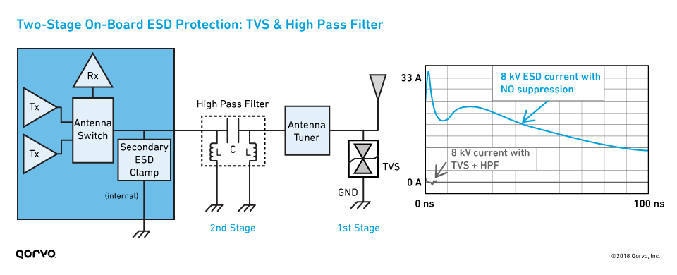

The best approach for ESD protection
Ultimately, you’re trying to reduce the voltage that the IC would see in an ESD strike; the goal is to reduce all the peak voltages before they hit the IC. We believe an ideal ESD strategy is the two-stage approach, with the first stage using a TVS element (TVS diodes) and the second stage using an HPF network.
Benefits:
  • It improves your board-level ESD protection and gives you the best opportunity to pass IEC testing.
  • It further reduces ESD pulse amplitude and residual voltages along the RF path.
  • Bidirectional TVS diodes help protect against both positive and negative pulses.
  • Any residual voltage pulses are clamped by the high pass filter.
  • Therefore, it provides optimum protection to the component pins.
Two-Stage On-Board ESD Protection: TVS & High Pass Filter
  • Use only the TVS.

Primary and secondary ESD protection
Understanding primary and secondary ESD protection is a fundamental part of SEED methodology. Typically:
  • Primary protection is done on the board and is called the primary clamp.
  • Secondary protection is done on the chip and is called the secondary clamp.
Co-design of the primary and secondary ESD protection stages is the fundamental concept of SEED methodology.
Let’s look a bit closer at primary and secondary protection:
  • Primary protection (on-board): This protection may include clamping components like shunt inductors or TVS components (diodes, varistors and spark gaps). These primary clamps shunt large ESD currents. Primary clamps should focus on external connections and other interfaces exposed to direct ESD energy ingress. They also play an important role in reducing the residual ESD stress that appears at the IC component pins.
  • Secondary protection (on-chip): This protection is used to clamp any residual ESD stress that builds up at the device pins. The shape of the ESD transient is largely dependent on the on-board primary clamp characteristics and PC board design.
Pros:
Cons:
Benefits:
