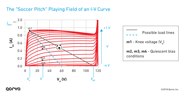

You can think of I-V curves a little like a soccer field — sometimes called a "pitch" — where the limits dictate the boundaries for the microwave signal, as shown in the figure below. In simple terms, once you hit the boundary, you get signal clipping, which causes compression and nonlinear distortion. The boundaries are set by the following:
  • The knee voltage and maximum current (Imax), indicated by the corner marker m1 in the figure
  • The zero-current line corresponding to the gate-to-source pinchoff voltage (Vpo)
  • The breakdown voltage (VBR) indicated by the curling up of the current line on the right
The “Soccer Pitch” Playing Field of an I-V Curve
Knee voltage, bias conditions and gain
The figure also shows the following:
  • Marker m1 indicates the knee voltage (Vk).
  • Markers m2, m3 and m4 indicate nominal quiescent bias conditions representing Class A, AB and B conventional PA operating classes or modes, respectively. To be sure, there are other modes — for example, Class C bias corresponds to a gate voltage more negative than the pinchoff voltage and consequently has RF current flowing for less than half a cycle of the input gate voltage waveform.
Remember: For GaN devices, the pinchoff voltage is always a negative voltage. Learn more >
The various curves represent different values of the gate to source voltage, from pinchoff (in this case, about ‑4 V) to slightly positive values (Vgs = 1 V). For this device, note that the absolute maximum current allowed (Imax) is about 900 mA, and the breakdown voltage (VBR) is around 118 V.
The spacing of the I-V curves for different values of Vgs is related to what is called the transconductance (gm ≈ ΔIds/ΔVgs), which in turn is related to the gain. (In this figure, the Vgs step voltage is 0.2 V.) Notice that in the vicinity of m4 (Class B bias), the curves are more closely spaced compared to m3 (Class AB). This is one reason Class AB, which has similar efficiency advantages as Class B, is often preferred due to higher gain.

How much RF power can I get?
The figure above also shows a dashed blue line and a solid dark gray line to indicate possible load-lines along which an AC signal would swing back and forth. In an ideal sense, the dark gray line allows for maximum use of the I-V “playing field” and would allow a signal to make use of the maximum current and maximum voltage swing.
In this example, the quiescent bias voltage might in principal be set to 61 V. However, for reliability and design margin reasons, I’d recommend a lower nominal bias voltage (always less than half the breakdown voltage) and different optimal load-line (here we chose 28 V, marked m2, m3 and m4 in the figure above). A simple rough estimation of the power potential of the device (for Class A and B) can be provided as 0.25*(VdsQ-Vk)*Imax. For the device shown here, this comes out to be about 5 W.
For a given process, the breakdown voltage tends to be constant, so you can obtain more power by increasing the gate width. This leads to a common metric for power capability called power density, which for GaN is on the order of 5-10 watts per mm (W/mm) of gate width, compared to 0.5 to 1 W/mm for GaAs transistors.
In simple terms, to maximize current/voltage peaks before clipping and thereby optimize power output, the load resistance would be the reciprocal of the load-line slope (neglecting device and package reactive parasitic effects). This optimal power load invariably is different than that needed to maximize the gain of the device derived from linear circuit theory.

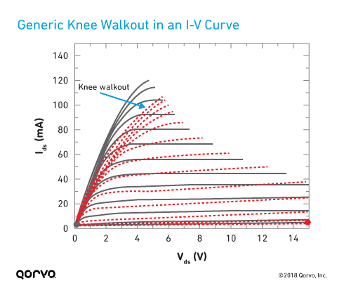

Trapping is an electrical phenomenon that affects both GaAs and GaN HEMT device operation. It occurs in the epitaxy layers of the device, where electrons that could be available to enhance current flow in the HEMT channel become essentially “trapped” in defect states occurring at the surface or within the GaAs or GaN lattice. This trapping is voltage dependent and degrades the device’s operation over time, affecting parameters such as the knee voltage.
One of the well-known consequences of trapping in GaN is called knee walkout, which moves the I-V curve knee voltage toward the right, as shown in the following figure.Generic Knee Walkout in a I-V Curve

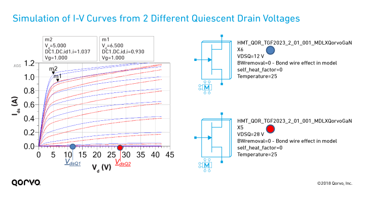

The good news is that nonlinear GaN models can help predict this trapping behavior. The figure below shows the I-V curves for one of the Qorvo die models, as captured in the Modelithics Qorvo GaN Model. It shows the simulation of two different quiescent drain voltages (12 V and 28 V, marked VdsQ1 and VdsQ2 below) under short pulse conditions (e.g., 0.5 µs pulse width at a duty cycle of 0.05%).
Note how both the knee voltage and Imax are affected by this trap-related knee walkout effect. With the self_heat_factor input set to zero, this model data recreates very well the I-V curves that were measured under short pulse conditions from 12 V and 28 V quiescent drain voltage (with VgsQ set to pinchoff).
As we know from the above discussion, both parameters in turn affect the maximum power potential of the device — so the model’s ability to track I-V changes with operating voltage can be quite important depending on the application.
Simulation of I-V Curves from 2 Different Quiescent Drain Voltages
