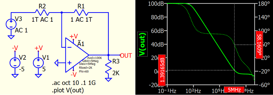

All that said, I will come to the point. QSPICE includes a new native circuit element in the interest of simplifying op-amp modeling. It is a transconductance that sources current from the rails (instead of magically operating as its own power supply), and as the output approaches a rail, it switches over to a resistance like a square law FET does. It acts like a well-designed complementary grounded source output stage of a Rail-to-Rail Output (RRO) op-amp.
The usual topology of an internally compensated RRO op-amp includes a Miller-multiplied capacitance from this output to an internal node. That topology is also a native circuit element in QSPICE. This simulation shows how to extract the open loop response of the QSPICE RRO op-amp native circuit element:
R1's value is "1 AC 1T." That means it's a 1 Ω resistor for the DC solution but a 1e12 Ω resistor for the AC analysis. Conversely, R2 is 1e12 Ω for the DC solution but 1 Ω for the AC analysis. The ability to use a different value for AC and DC is from HSPICE¹ and is used to solve for the bias point as a voltage follower but then do the AC analysis directly in open loop. Instance parameters Avol, GBW, Slew, and Phi are the Open Loop Voltage Gain, Gain Bandwidth, Slew Rate, and Phase Margin, respectively. Because an RRO has a high impedance output, the voltage gain is essentially infinite. That's why the parameter Rload is necessary to specify the load resistance used to measure the open loop voltage gain.
Simple-minded equations are used to set up the RRO Op-Amp device. In the waveform window, the cursor is set to 5MHz, but the gain is 1.4dB instead of zero and the phase shift is 58° instead of 60°. Adjust the instance GBW and Phi to match the op-amp of interest.

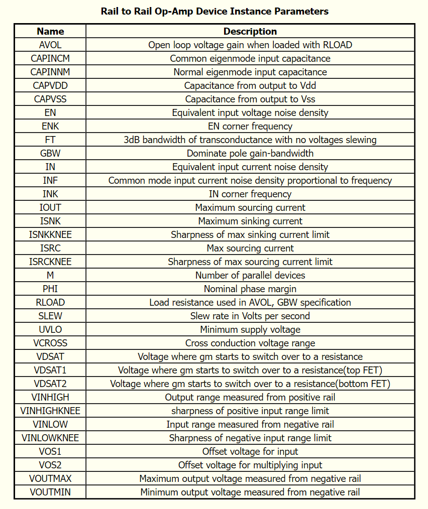

The RRO device supports everything necessary to model a complete op-amp: dominant pole, phase margin, stochastic noise, input capacitance both normal and common mode), voltage and current output capability, etc. Below is the full list of instance parameters:
And, yes, you can give it an offset voltage directly as an instance parameter to determine the impact of device precision and scatter.
Let me clarify the input capacitances, CAPINCM and CAPINNM. CAPINCM is the capacitance seen when both inputs are driven together, and CAPINNM is the capacitance seen when driven differentially. This is not the capacitance between the inputs but the capacitance that is of interest in stability analysis of the normal mode. Some IC manufacturers mistakenly list the pin-to-pin capacitance on the datasheet as the normal-mode capacitance.

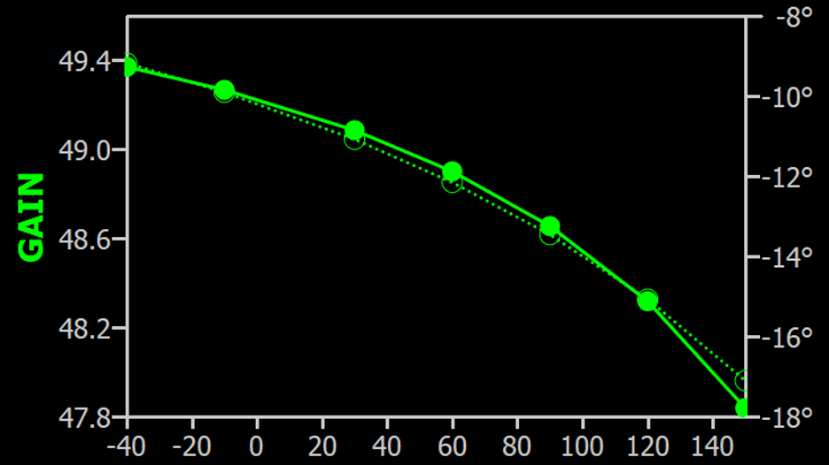

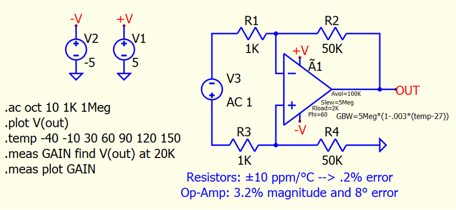

The QSPICE RRO Op-Amp device also enables you to investigate your circuits' behavior over temperature in a way that normal vendor-supplied op-amp models do not. You can adjust the GBW in the interest of considering the effect of temperature on your op-amp circuit. When you have a simple resistive feedback network, the phase shifts before the magnitude, which causes data acquisition errors.
The example shows how to add a temperature dependence to the GBW:
I’ve simply written the value of the GBW as an expression that includes its tempco.
In signal conditioning, the temperature dependence of op-amp GBW can cause an error that easily exceeds the error due to the temperature dependence of the passive components. For example, it's straightforward to specify 25ppm/°C resistors, but let's say we go with 10ppm/°C. That yields a .2% error from -40°C to 150°C. In this simulation, we see a 3.2% error in magnitude and 8° error in phase for a hypothetical analysis frequency of 20kHz, as might be used in prospecting for oil. This is a plot of gain over temperature considering only the effect of the op-amp’s GBW temperature dependence:
The QSPICE RRO Op-Amp device will allow you to design a data acquisition system and predict its performance downhole or on the surface, no matter if it's in the Arctic or Sudan.
