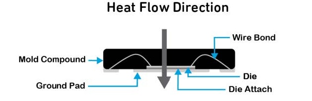

Thermal design is a complicated subject, but there are some fundamentals that should be explored. Let’s review some basics of using a molded semiconductor on a printed circuit board (PCB). The first thing to consider is the heat path, which provides a route for heat generated by a semiconductor to the ambient air of the outside world. This heat path should generally go through the bottom of the device package through the ground pad (see Figure 1). Therefore, the application design should incorporate a PCB that pulls the heat from the bottom of the package through the device ground slug.
Figure 1. This over-molded part shows heat flows from the top of the die down through the package ground pad.
In this type of package, attempting to draw heat from the top of the package will not work due to the poor thermal conductivity of the mold compound, trying to cool it from the top will cause device degradation or failure due to high junction and channel temperatures.

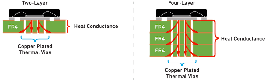

Additionally, the PCB’s thermal resistance is proportional to the overall thickness of the board – and thermal vias also play a part in this resistance value. Thus, a very thin PCB such as 8-mils is often used for high-power GaN in a quad-flat no-leads (QFN) package to keep the thermal resistance as low as possible. The thermal performance of a PCB material is also dependent on the way the copper is laid out on the board.
To move heat downward to where a heatsink is attached, you will need to use thermal vias at a minimum. These are drilled holes plated with copper to provide thermally conductive pathways from one copper layer to the next. The thicker the copper, the better, as it provides an excellent conductor for heat to dissipate, but the more copper used, the higher the cost.
In lower-power applications, adding layers to the PCB has a big impact on heat conduction away from components. The difference between a two-layer and a four-layer board can be as much as 20°C depending on how well the copper planes are laid out for heat spreading (Figure 2).
Figure 2. Heat conductance – two-layer versus 4-layer PCB.
Although adding layers of PCB is a benefit in a low-power situation, doing so in high-power applications has the opposite effect. Adding PCB layers in applications such as GaN high- power devices, especially above 10 to 15 Watts of power, increases resistance and interferes with the heat path.
