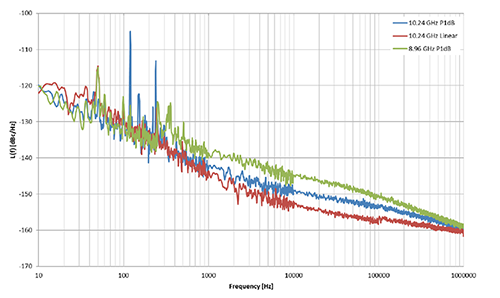

In an ideal situation the answer would be “no”, as the amplifier would simply raise desired LO signal and the skirts by the same level. However, in reality, microwave amplifiers add noise of their own to any signal, and herein lies the problem. All electronic devices exhibit a phenomenon called 1/f noise or “pink noise”, which is noise power that is added to an input signal spectrum but falls off proportionally to the inverse of the offset frequency. In Figure 4, we present the phase noise of the CMD307P3, a low-noise amplifier covering the 10 to 17 GHz range, versus offset frequency away from the desired signal. The phase noise of the incoming signal has been canceled out, so this plot represents the noise generated by the amplifier.
Graph of the CMD307P3 LNA Phase Noise
Figure 4: CMD307P3 LNA Phase Noise

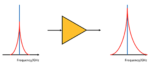

In Figure 4, we note the phase noise falls off linearly on the logarithmic scale with increasing frequency offset, which is characteristic of 1/f noise. If this noise level is higher than the phase noise of the input signal, the amplifier noise would dominate the output noise spectrum. In our example, this means the low phase noise of the oscillator would be replaced by the higher phase noise of the amplifier, thereby defeating the purpose of the low-phase-noise oscillator. A pictorial representation of this phenomenon is shown in Figure 5.
Visualization of degradation of phase noise due to an amplifier
Figure 5: Degradation of phase noise due to an amplifier.
The skirts of the input signal on the left are increased after passing through the amplifier, with the output spectrum on the right.

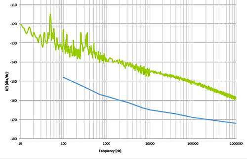

One obvious question is - Can anything be done to lower the phase noise of amplifiers? The answer lies in device physics. The 1/f noise is caused by random and thermal charge movement in the channel of an active device. The CMD307P3 for example, is manufactured on a Gallium Arsenide (GaAs) pHEMT process with a gate length of 0.13 um. The FET devices on this process typically have a high 1/f corner due to their high electron mobility. GaAs bipolar devices on the other hand, tend to have lower electron mobilities, which means a much lower 1/f noise. So they are considerably better for phase noise than their FET counter-parts. Therefore, one solution to lowering the additive phase noise is to use a GaAs HBT process.
At Custom MMIC we have used our extensive knowledge of amplifier design techniques to create a family of new Low Phase Noise Amplifiers (LPNAs) on a GaAs HBT process operating from 6 to 40 GHz.
In Figure 6, we present the phase noise versus offset frequency for the CMD245 amplifier as housed in a 4 mm QFN-style package, relative to the CMD307P3 HEMT LNA shown previously. We note the phase noise of the CMD245C4 is 15 to 20 dB lower than the CMD307P3 pHEMT LNA.
Graph of phase noise of the CMD245C4 vs. CMD307P3 LNAs
Figure 6: Phase noise of the CMD245C4 (Blue) low phase noise amplifier vs. CMD307P3 (Green) LNA.
