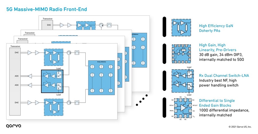

figure 1
Figure 1: Components of an RF Front-End
Since 5G uses a TDD transmission scheme, the receiver front-end is more susceptible to failure from a high-powered signal transmitted from a radio's power amplifier during transmit mode operation. Hence the first stage LNA should be capable of handling greater than 20 dBm of input power level. This adds stringent robustness requirements on the first stage LNA. Apart from TDD operation, any antenna fault arising on the network equipment could also lead to high power getting reflected into the receiver. LNAs used for this application which are not rated for high input power levels will have decreased reliability, inferior performance, and degraded noise figure. A damaged receiver front-end can lead to downtime and loss of service, impacting network provider's revenue on top of expensive site repairs.

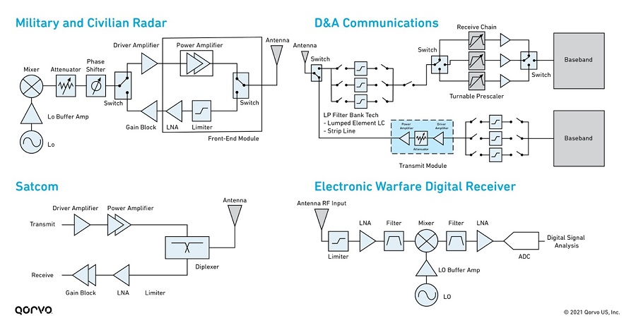

Demanding requirements and new technology developments drives defense and aerospace (D&A) RFFE systems to evolve quickly – especially in the military radar, satcom, electronic warfare communications and digital receivers. Figure 2 shows different RFFE block diagrams for various D&A applications. With recent semiconductor advancements there is a clear push for devices with small form-factor, lightweight, and high level of integration in both transmit and receive sections. Similar to 5G, as one would expect, these features are just as appealing to the defense and aerospace arena and aligned with the SWaP – size, weight, and power – objective.
Figure 2: Examples of RFFE's used in defense and aerospace

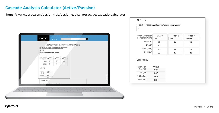

Figure 3: Qorvo's Cascade Calculator on the Design Hub

figure 1

Designers must make crucial tradeoffs between parameters like gain, gain flatness, input/output match, linearity, power consumption and size, while keeping the system stable over the full range of operating conditions. While a low receiver noise figure is the primary goal of system design, there are always tradeoffs a system designer must make such as sacrificing NF, return loss to improve other parameters. Qorvo's helpful cascade analysis calculator, shown in Figure 3, can assist in providing a starting point in these system-level designs and tradeoffs.
