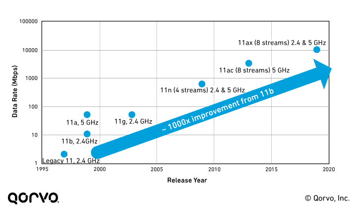

One of the major changes over the years of 802.11 is data rate. With the evolution from 11b to 11ac and toward 11ax, the data rates have shown a 1000x improvement. It’s important to note, however, that even though 11ac was able to achieve roughly 7 Gbps, it did not achieve that rate in practical applications (e.g., dense and crowded venues such as stadiums). That practical, “real-life” achievement of up to 10 Gbps is one of the major goals of 11ax, as shown in the figure below.

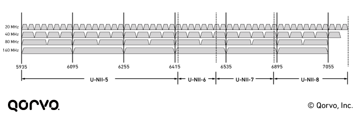

The chart below shows definitions of U-NII-5 through U-NII-8 channels from 20 MHz up to 160 MHz bandwidths:
The band expansion of 11ax is especially significant as it will provide a much needed additional 160 MHz channel capability. It will also help with the current congestion in the 5 GHz band with LTE and LAA. This expansion will take hold rapidly in the industry, with many products expected to launch very quickly.
