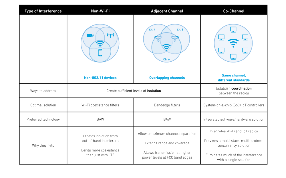

    Three primary types of interference can affect Wi-Fi systems: non-Wi-Fi, adjacent channel and co-channel (Figure 2).
    Figure 2. The Three Models of Wi-Fi Interference
    There are two primary ways to address coexistence and interference within Wi-Fi CPE units (Figure 3):
    • Establish coordination between the radios. Preventing one radio (Wi-Fi, Bluetooth, Zigbee, etc.) from trying to talk at the same time as another can avoid potential co-channel interference. This can be achieved using a system-on-a-chip (SoC) solution that supports multiple standards and coordinates communication among them.
    • Create sufficient levels of isolation between potential sources of interference. This can be accomplished using RF filters and by managing the board layout and antenna design. Filters are the most cost-effective and scalable approach. They help with adjacent channel and non-Wi-Fi interference.
