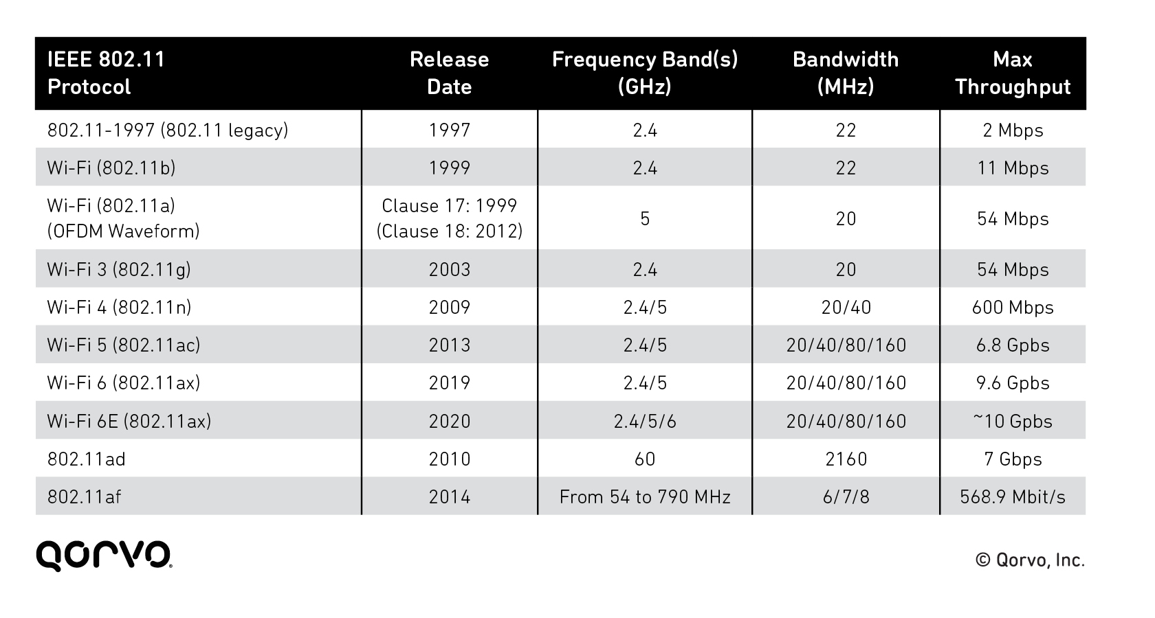

As shown in the table below, Wi-Fi's initial upload and download speeds were not very impressive when compared to a wired connection. But around 2009, with the introduction of the 802.11n standard, the speed of a wireless connection began to match that of wired home and business data rates. Since then, wireless speeds have competed head-to-head with wired speeds, adding the much-needed convenience of no-chord connectivity with improving performance in each successive generation.
Table 1. Summary of Wi-Fi Standards

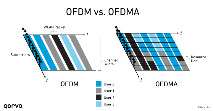

Wi-Fi 6 (802.11ax) is the current and sixth generation of Wi-Fi. Built on the strengths of 802.11ac, it provides more wireless capacity and improved reliability. By using denser modulation (1024-QAM), orthogonal frequency division multiple access (OFDMA), reduced subcarrier spacing (78.125 kHz) and scheduled-based resource allocation, Wi-Fi 6 offers four times more data throughput than its predecessor. 802.11ax is a dual-band 2.4 and 5 GHz technology providing maximum compatibility and coexistence with 802.11a/g/n/ac clients. With OFDMA, shown below, the resource units divide bandwidth according to the needs of clients and provide multiple individuals with the same user experience at faster speeds.
Figure 1. OFDM Versus OFDMA Resource Allocation
